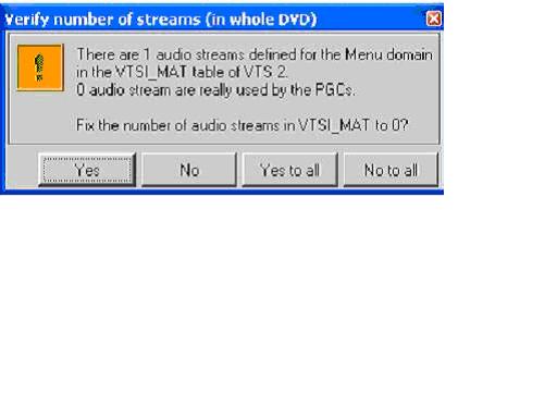

I've tried it several times. The last 2 attempts I did the following. I open the DVD and it scans for BOVs. It then displays the following warning which makes no difference if Yes or No is selected. I save the DVD and open it with a software player and the commentary track is lost thru the menus. Prior to going into PgcEdit, it works. I know enough to be dangerous but definitely not enough to follow the Trace and choose the correct audio stream.

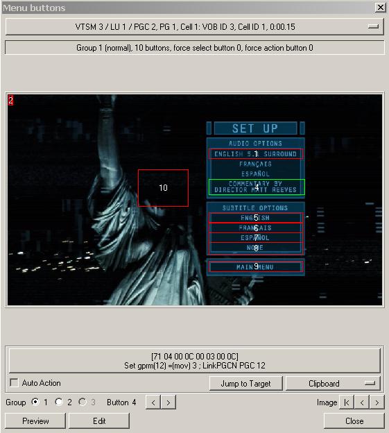

In the process of doing whatever you did, did you manage to change the audio stream number for this commentary track? That is, did the commentary track perhaps go from being the 4th audio stream (after the English, French, and Spanish language tracks) to being the second one? You should be able to figure it out by comparing the PGC Editor screen for the original DVD with the one from your processed DVD. If that's what happened there are a number of ways to fix it, but perhaps remapping it so it's the 4th again is the simplest.
That pic has nothing to do with anything. -

I've traced the commands after selecting the Commentary then Play buttons. It initially shows the Commentary track selected, but as the trace progresses, it changes to the main english track. When I see it change, how do I set it to the correct stream?-The Mang -
Because, as I was speculating, by deleting the 2 tracks you changed the commentary track from the 4th stream to the 2nd one. When you chose the commentary track in the menu, there was no longer a 4th stream to go to, so it went back to the first one (the English dialog track). Disabling the unwanted tracks keeps the Commentary track in its original 4th position. You still could have completely deleted the unwanted audio tracks. It would have just meant remapping the Commentary track.Originally Posted by louv68
I actually stripped the French and Spanish audio tracks with VobBlanker beforehand. Even though they were actually gone, they were still visible. That is what I was trying to get rid of.Originally Posted by manono
You were exactly right about this. I guess I never experienced this problem before since I usually only keep the 1st audio stream. This one, being the 1st and 4th streams, goofed things up.Originally Posted by manono

You can also modify the menu commands in the Menu Buttons page, but that's perhaps a bit more difficult (sometimes). That is, instead of having the button point to the 4th audio stream when you want to choose the commentary track, you can have it go to the (now) 2nd stream. -

then that will require messing with the menu commands, and doing that can range from very easy to pretty difficult and beyond my knowledge (not that my knowledge is all that great). In your case it should be fairly easy. Taking a look at the Audio Set Up menu, and specifically the command to turn on the commentary track, we see:
If you change (mov) 3 to (mov) 1 (change it from choosing the 4th audio track to choosing the 2nd one), you should be in business. To do that, just click on that wide bar with the command and in the PGCEdit - Command Editor change the value 3 to 1.You'll have to do it both in the Audio menu and in the Special Features menu. But there are different ways different DVDs handle this, and I don't know if an all-inclusive guide can be written to cover all possibilities. -

Wow, that was too easy! Thanks manono.
