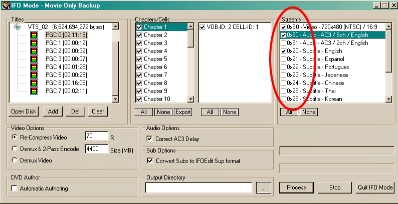

  14. Member AlanHK's Avatar
    Apr 2006
    Hong Kong
    Originally Posted by JBredensteiner
    I downloaded ReJig, and at first I was really excited because it seemed to work really easily, but after I converted a couple of movies I found out that the sound wasn't working. Do you have any idea why it isn't working for me, and why it uses .m2v instead of .mpg for the file extension? I'm running Vista, and I see that this application hasn't been updated in a few years, so that may have something to do with it.
    Rejig works fine.
    M2V is just video (no audio). It can compress that if you want.
    It can also save out any soundtracks (normally AC3). You choose which ones you want. None are selected by default. Also it can extract subtitles, as SUP files.
    (See the "Streams" checkboxes on the right, circled in red.)
    The idea is that many DVDs come with multiple soundtracks, and you probably don't want a lot of foreign languages. (You may want a commentary track if there is one though.)
    You can use Rejig to reauthor using the m2v, ac3 and sup files it extracts, or many other authoring apps if you want menus, etc.
