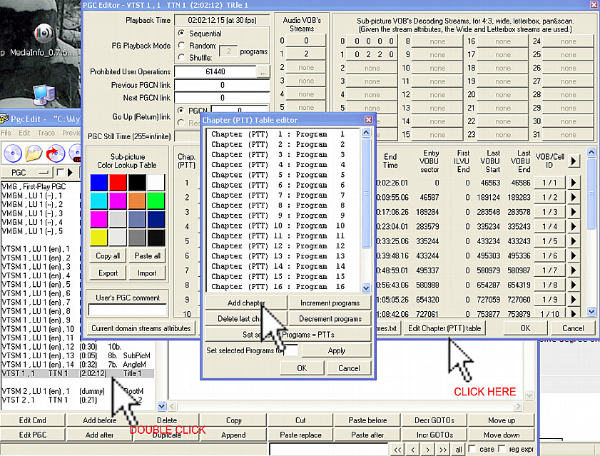

I think you only can do it (within Pgcedit) in 2 cases:
1. There is a cell in an existing 'chaptered' program (with more than 1 cell) suitable for making a chapter.
In PGC editor (right-click on the PGC -> Edit PGC) it will be shown without chapter number (left column). If you press that cell button, a new program will be created from it and it will be assigned to chapter with all other chapter numbers remapped so, that the last program will lose its chapter assignment -> you open 'Edit chapter table' and use Add Chapter button to correct this.
2.There is a program (in suitable place), not assigned to chapter.
Then you can select it in Chapter table editor (accessible from PGC editor, picture in the post above
) and use 'Set selected programs = PTTs' button.
In both cases, if you had menu links to chapters, the button commands will need chapter number correction.
In other cases you'd want to split a cell in VOBBlanker, then pass the result to PGCEdit. -

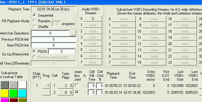

I think if I use PGCDemux or Muxman just one more time the ailing hard drive is going to fly out of the computer. I want to do this in the IFO, or it is not worth doing. Below are two Pgcedit screenshots that show what I have now. Can you tell from these screenshots if I can do this with Pgcedit? There are no chapters or menus on the DVD. On the other hand, can DVDRemake do this job easily? If so, I will give it a try. There have been some comments that I should replace the hard drive first. No, I want to witness total failure first. I have everything backed up on DVD and CD.
There is only one cell #2, where you will be able to add chapter point #2.
PgcEdit cannot split cells, to add any more chapters.
DVDRemake will let you do that, so you will be able to add as many chapters you like.
The problem will be that you will be able to jump from one to the other with remount control only, since you do not have a chapter menu with buttons. That part will require re authoring DVD. -
