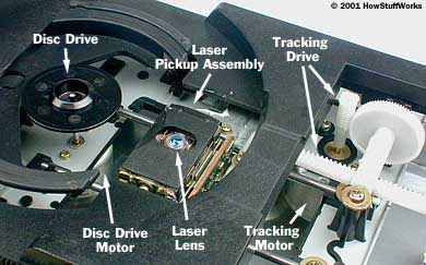

    Sometimes it's not only the laser that wears out. The mechanism that moves the laser lens can also be sticking or the feedback mechanism that focuses and aligns the laser may be having problems.
    What a CD laser assembly looks like. A DVD assembly is similar:
