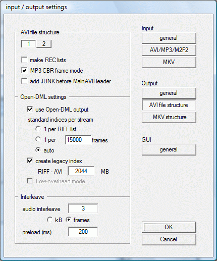

About the file size thing: I'd never tried to play a file greater than 2GB on my 5990 (I read a long time ago that that was troublesome on some of the older players like the Philips 642, which I used to use, so I just don't make them that big). After seeing your post I thought I'd check it out.
The largest AVI I had was 1.9GB, so I clipped about 700MB of it and added it to the end of the original file to give me a new file of 2.6 GB (I used Virtualdub mod), then copied the original and the larger file to an 8 GB thumb drive. The original file played fine, though it did take 30 seconds to load. I gave up trying to play the big file after waiting for it to load for about 7 minutes.
I then took the big file and remuxed it using Avimux Gui 1.17.7, copied it back to the thumb drive, and this time it played fine. It took 58 seconds to load. Fast-forwarded to the new section at the end and there were no problems with playback.
Going beyond 2GB makes the file into a multi-part OpenDML, which apparently can be handled in different ways by different muxers. I don't pretend to be an expert on this, but there's a discussion here if you're interested:
http://www.alexander-noe.com/video/amg/en_about_opendml.html
So I'd recommend re-muxing your big files using Avimux Gui. It needs to be configured properly, though. To do so, open Avimux, then open an Explorer window, go to the "Profiles" subfolder of your Avimux installation, and drag the "Profile - Standalone AVI - MP3.amg" file into the "open files (add files via drag & drop)" window of Avimux Gui. Nothing will appear to happen, but this will take care of most of your settings. Now click on the "settings" button, then "AVI file structure". This section may have already been set by the profile (it's been so long since I've set it up, I don't remember), but if not, then put a check-mark next to "use Open-DML output" and "create legacy index", and in the RIFF-AVI box, enter 2044 (see screen-shot below).
To remux, just drag your big avi file into the "open files" window, click on it, then click on "generate data source from files" just below the "open files" window, then click on "start" and specify a location and a new file name. Re-muxing is very fast, approximately as long as it takes to write the new file out.
Alternatively, you could just split the big file into smaller sections using Vdub(mod).
