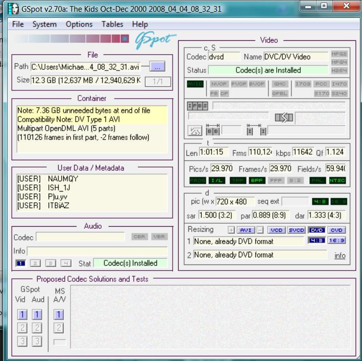

OK here is what I got when I ran gspot on one of my files. What does this tell me?

When I looked through the gspot report, I noticed that there is a blank in the sound file area. Which makes sense because I cant hear anything when I open the file in virtual dub 1.8. But when I open the same file in Windows media player, I hear the sound fine.

You have Type-1 DV AVI files - they don't have a separate sound track. It stores the DV in the way that DV is - i.e., the video and the audio are together.
Type-2 DV AVIs have the same information in the same way but also an extra copy of just the audio.
The reason for all this is that older video software can't understand the Type-1 (they can't "see" the audio mixed in with the video) so MS created this second type that appears like older files to older software.
