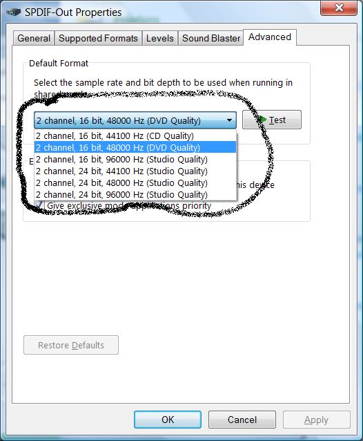

    Is this what you mean?
    That is what my usb soundblaster can do right now.
    Thanks for the insight.

    Can the high def dolby go out through spdif? Is that high def dolby on bluray now? Or is bluray only the lossless pcm? I can never remember which is which.
    Actually I could always just hook up my 360 hddvd drive to my pc and test it out that way. I do have powerdvd ultra.
    EDIT - I was able to get 96khz out to the receiver. The receiver reads it as 96khz through the spdif. HOWEVER it is in two channel mode only. Is there any way to get it to read the surround info in 96khz mode? ISn't that the high def level? I have the xmen 3 bluray disc going at dts master audio but it is only outputting stereo in 96khz mode. I get full surround dts if I output at 48khz at dvd audio level (normal 5.1). Is this a limitation of the soundblaster drivers or my receiver? It is a SONY STR DE475.
    More probably, it's a limitation of any software legally-licensed by DTS, Inc.
    If you don't want to use HDMI for getting full-quality unscrewed audio ,
    you should be allowed to use your sound card to produce a multi-channel analog output ---
    which of course will require an adequate multi-channel analog amplifier.
