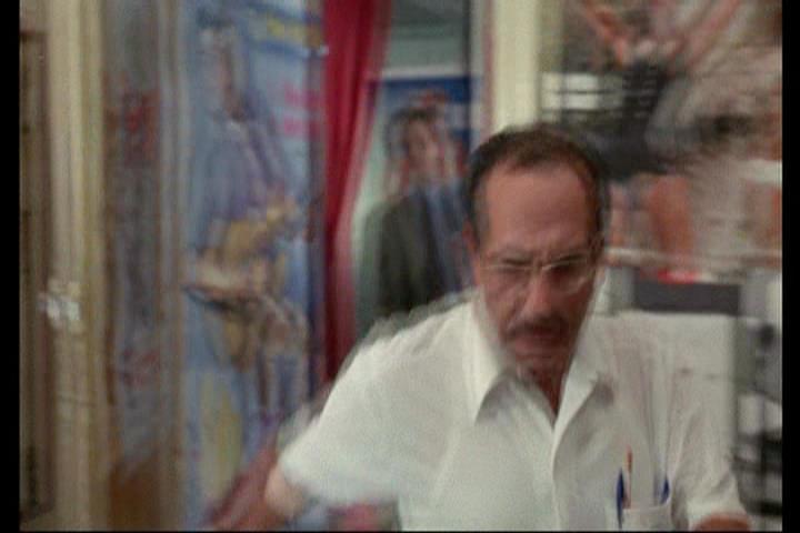

    now and then I come across some NTSC DVD that present some problems of image.
    I’m not an expert, although I can work with avisynth scripts, but the thing is I would like to know which is the best proceeding to fix it, if possible.
    This one is a NTSC 29.97 and you can see clearly the ghost effect when there’s some lateral movement.

  5. You have a field blended PAL to NTSC conversion. Look into AviSynth's RePAL filter. It won't be perfect but it will be much better than a straight deinterlace.
    MPEG2Source("Z.demuxed.d2v")
    TDeint(mode=1, order=1)
    RePAL()
    z.demuxed--mpeg2dec.avi
    It takes Repal() a few frames to sync up so the first few frames are interlaced.

  7. I loaded the m2v file in VirtualDub, added the deinterlace filter in "duplicate field 1" "duplicate field 2", "discard field 1", or "discard field 2) mode, then stepped through the video. A normal interlaced video will show no comb artifacts or blending (double exposure) artifacts. Field blended PAL to NTSC conversion will show blending artifacts.

  10. To just view the individual fields you can use Bob(). If you see blending in some of the fields and the video is 29.97 fps it's usually a PAL to NTSC conversion.
    You can't simply deinterlace or inverse telecine this type of video because the individual fields are contaminated (paritially blended) with other fields. RePAL uses special techniques to remove the contamination.
