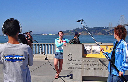

Basic Boom Kits
http://www.4videoequipment.com/video/Store2/Scripts/prodList.asp?idCategory=1099
A broom stick could work
