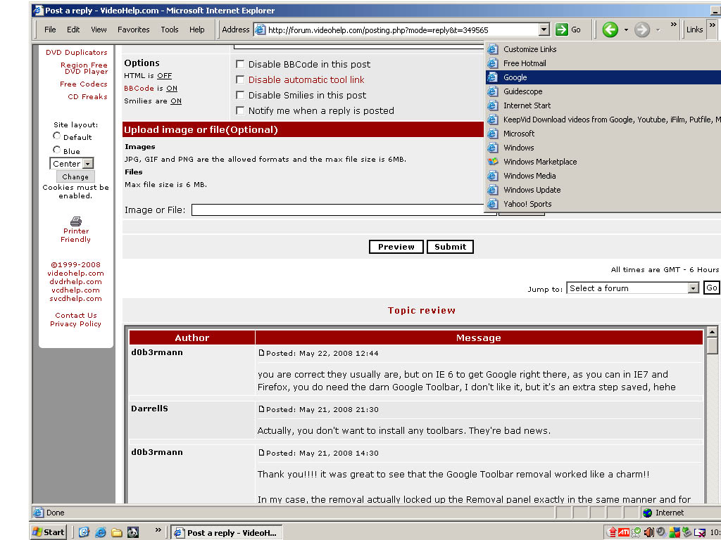

	Actually, you don't want to install any toolbars. They're bad news.
	you are correct they usually are, but on IE 6 to get Google right there, as you can in IE7 and Firefox, you do need the darn Google Toolbar, I don't like it, but it's an extra step saved, hehe
	I just put a link to Google in the Links folder. Easy enough to get to. I don't care for IE7 or Firefox. The toolbar takes up half the page and I like opening web pages in separate windows and keeping them on my taskbar instead of using tabs.
