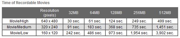

I looked up the specs for the camera and it says, 2048 x 1536. Bu you said file specs and so I don't know how to find that. (I am sorry I am a moron) I also copied this, maybe it will help. Movie Clips Yes, 640 x 480, 30 secs, 320 x 240, 160 x 120, 15 fps, max 3 mins, with audio.
So, I am taking the video files from the camera (AIV) and converting them into DVD burnable files (VOB) and then using Nero to burn them unto a DVD. (-r). I think I found the file specs you wanted.. This is what I found:
Width 320 pix Height 240 pix bit rate 88kbps. I checked and that is for all the videos. I really hope that helps.

It is going to look pretty average no matter what you do to it, but I would suggest using FAVC in VCD mode. It will produce a VCD resolution DVD structure ready to burn. If it cannot read the file you may have to install FFDShow to provide mjpeg decoding.Read my blog here.
If you had told us you were using video from a digital camera or mentioned the Canon PS A75 in your first post, this would have been a lot simpler.
Digital cameras take mediocre video at best most times. As guns1inger mentioned, FAVC at VCD resolution may work well. If you used the 640X480 mode, that might be better at DVD resolutions. Windows Movie Maker should also accept that format if you wanted to edit, but you would want to output as DV-AVI, then encode that to your DVD format.
You can take the video file from the camera and drop it into Gspot. It will tell you the resolution and format. I suspect MJPEG. Those cameras can output:
But I don't see the fps (frames per second) listed anywhere. The NTSC format that is used in the US is generally 29.70fps or 23,976fps for a video that will work on a DVD or VCD. Gspot would tell you you the framerate. I suspect 30fps or maybe 15fps. I would switch it over to NTSC, just for TV display and see what it looks like on a TV direct from the camera. That is likely the best it will look on a DVD or VCD disc also. -
