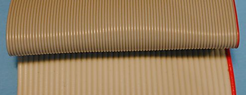

Thanks i need to find a picture of the 80 wire since i get confused with the wiringin. I set the pioneer to master. So far so good. Quiet and smooth. I have a dell XPS600 system, perhaps this weekend i will check the wire, buy an 80 if i need it, and change it to CS. Thanks all. Now in search for a picture of the 80 wire. Hope i find one.

Thanks all. The wire is suppose to be brown? Mine is blue. Is there a difference in color?
Color doesn't matter - most I've seen are blue actually.Originally Posted by mn072065
