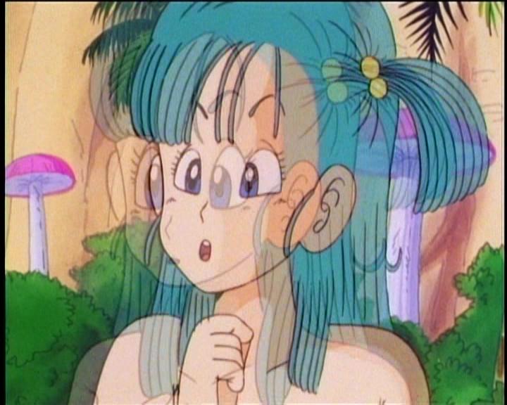

I am trying to encode my anime DVDs to x264 but when I'm done and I play my encoded file, I see way too many frames that look like this:
It's very annoying on the eyes. Is there a way to correct this sort of thing?

Hey poisondeathray, thanks a lot for taking a swing at it
Although, your encode came out exactly the same as mine. Here is that same frame from your encode:
You can see it still has that same problem during the movements
I don't know why this happens...
I think these bad frames need to be removed somehow.

it's going to be hard to get rid of, as it's in your source that way. badly done transfer to PAL format would be my guess.
"a lot of people are better dead" - prisoner KSC2-303 -
Yeah that's what I was thinking... uggghh I can't believe I wasted my money on this crapOriginally Posted by aedipuss
So how hard is it exactly? Is it even possible at all? Maybe somebody out there knows something... -
i should have said not possible, as it's hard encoded that way into that single frame. sorry

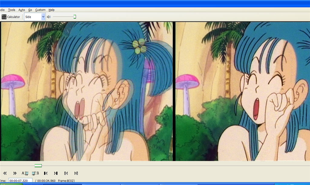

Wow sorry, I should have checked my video first

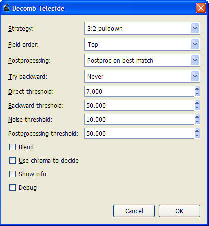

Anyway you can play with the filters and display them side by side using avidemux, and make adjustments observing the changes "on the fly"
I used decomb telecide with post processing on best match. You can probably fiddle with it and get better results.

I'm still waiting for some of the village elders to explain the technical explanation and the "correct" way to undo the interlacing...but aedipuss is probably right, that is encoded into the orginal .vob
WOW thanks for not giving up on me poisondeathray!
That sample you uploaded appears to be problem-free!
Maybe I didn't waste my money after all? Perhaps there is hope! -
