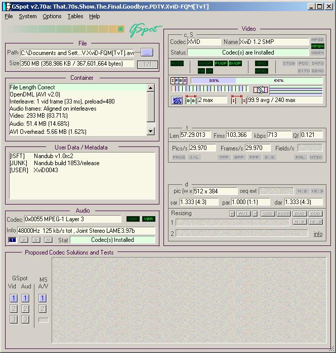

I discovered that the only difference between the two AVIs are the frame rates. However, if I change the one in VirtualDub, everything becomes screwed up... arg!
