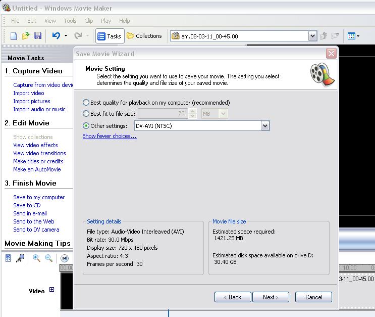

  2. The usual "mistake" made with WMM is saving the edited video in a low quality format. This is because of the somewhat clunky way the software assumes what format to use. You can tell WMM to output to DV format which will be the same quality as your input.
    Have you watched the edited video from WMM before putting it through Nero? If the quality is poor then the above is probably the reason. If not, then the DVD encoder settings within Nero need changing.

    WMM hides the DV-AVI export here. Export your edited timeline to DV-AVI and import that file to Nero.
