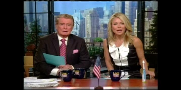

Look at this one, they go to a letterbox NBC promo while failing to blank data lines. Pure incompetence.
Much of this will be corrected after Feb '09 when they don't have to dual feed NTSC and upscaled 4:3 at the same time. They can concentrate on correctly formatting their DTV feed. Until then, we will be living with a lot of 4 side crops on the upscaled HD local channel.
They must do this or the 4:3 sets just see cropped action. Programs framed for 16:9 need to be shown letterbox on 4:3 sets. Programs shot for both like TV series or news must keep the center 4:3 crop action safe.Originally Posted by yoda313
HD recording decks cost $59K and the sports dept probably has no HD edit suite. Stations budget first for the new DTV transmitter and network to air HD master control equipment. Some stations do HD studio News but use mostly upscaled SD field footage. Few can originate and edit local HD yet.Originally Posted by yoda313
HDTV sets vary in modes and the names used so pictures better tell the story.Originally Posted by yoda313Recommends: Kiva.org - Loans that change lives.

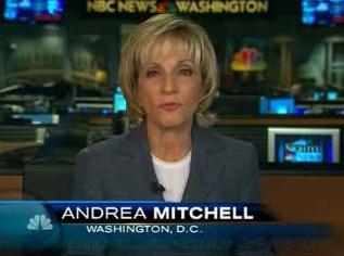

I also notice that some HDTV channels will have junk on the top and/or bottom. Usually it appears during the commercials (which are often 4:3) than the actual HDTV show itself. Basically the same as the first two images posted by EdDV.
