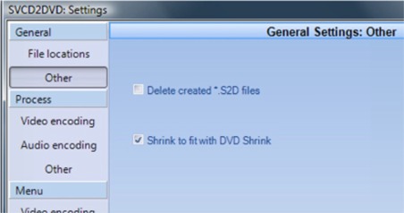

It's a source related issue, some aren't targeted accurately for conversion. That's what this option is for:

No, you only transcode once - with Shrink. SVCD2DVD uses an encoder.Originally Posted by jeffnoone
It's a percentage deal with shrink, 2.5% reduction will get you better results than 50%

That's exactly the question you raised - 2.5% reduction is better than 50% reduction with a transcoder. As to innaccuracies, I would challenge you to show me the difference between the original and a 2.5% reduction fron Shrink.But that wasnt really the question I raised
If, as you say, you are aware of the difference between an encoder and a transcoder, then you already know it's better to let the encoder do the heavy lifting...Dwight
