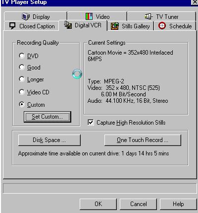

    I found this picture of the MMC menus on Lordsmurf's site www.DigitalFAQ.com
    He has much info there on AIW cards.
    You will find MPeg2 settings under "Custom"
    http://www.kiva.org/about

    I've been there. (I am trying to do my homework.) But I can't figure out how to get to any controls for my card. Maybe because it's Vista (ptui!), but I cannot get any menus that have anything to do with the card. I know it's there because Roxio captures stuff with it. I'm going nuts here. Computers were hard before Vista, but never this hard.
    Thanks for working so hard to help me. I'm embarrassed that I can't figure this out myself. I am trying though.

    Then you aren't using the ATI AIW MMC software. That is needed to get hardware compression from the AIW cards.
    If you are using Roxio, then the settings are in the Roxio software. Extreme realtime software only compression requires a very fast computer and even then quality will suffer without using the hardware on the ATI card. I suggest you get ATI MMC software installed or buy a new card like a Hauppauge PVR-series or the ATI 650 capture card. The Hauppauge PVR cards will have better support.
  29. Member
    Apr 2008
    What a frustrating day! I downloaded the ATI software but it WILL NOT INSTALL. It looks like it's installing, but there's nothing there when it's done. I'll contact ATI when I'm done my taxes--the only thing more frustrating than dealing with this video stuff, in spite of all the generous help I'm getting here.
    Sigh.
    The Roxio settings only offer HQ, SP, and LP (8, 6, and 4 MBps I gather.) The card IS an ATI 650, but if I can't install the software, I can't set the bitrate.
    Ah well, thanks to all who've offered their help. I'll post an update if I resolve anything.
    - charles
