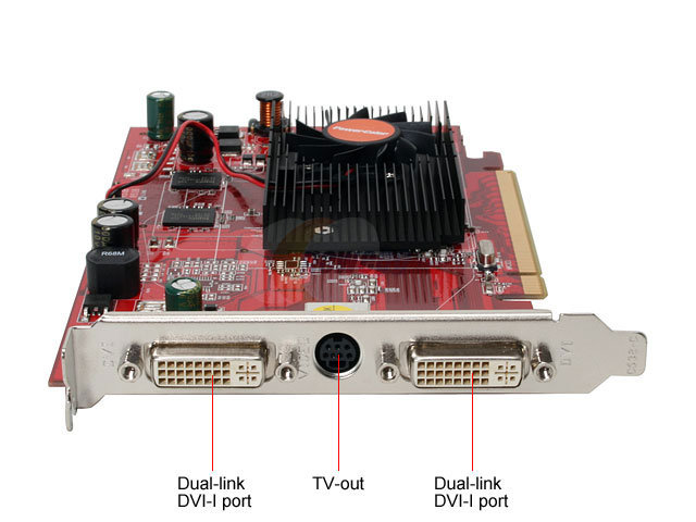

	Dual monitors can be either VGA or DVI most commonly. Quite a few video cards can run two monitors. If you get one with dual DVI out, you just plug in two DVI monitors. If it has one DVI and one VGA, many come with a DVI>VGA adapter to give you two VGA outputs. Then you would use VGA monitors. I'd probably go for wide screen monitors.
 I would look for a dual DVI card and use DVI input monitors. It's easy enough to set them up.
 They also make fairly expensive dual monitor cards, like some of the Matrox cards. But I've had no problems with regular two output video cards.
 Here's an example of a cheap ($40US) card with dual DVI, so it's not hard to find one for a reasonable price: (But I would pay a bit more than that. ) )
