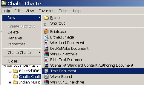

Thanks for your help but I need more help here. How to create a text file? and can I create chapters at different time intervals?
Hi-
How to create a text file? Well, I usually do it by highlighting the folder where the video files are and then File->New->Text Document.
Can you create the chapters any place you want? Yes, but you'll have to figure that place by the 29.97fps frame number that Muxman requires. I gave you a simple way to create them before. If it were I, I'd create a 29.97fps AviSynth script file and scroll around in VDubMod taking note of the frame numbers of the major scene changes where I might want to create chapters 5-10 minutes apart. But unless you know some AviSynth you won't be able to do that. If your source is an AVI, you could open it in VDub(Mod) and scroll around looking for the frame numbers where you'd where you'd like to create those chapters, and then convert the 23.976fps frame numbers (if that's the source framerate) to 29.97fps frame numbers by multiplying each by 1.25. It'll take some figuring for each chapter point, but in principle it's not all that hard.
I don't know your source or how you converted it to DVD, but you have to know either the frame numbers or the times where you'd like to create chapters, and then convert them properly. -
