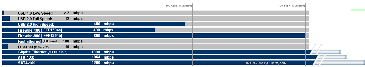

    is usb speed equal to sata speed?
  8. Mod Neophyte redwudz's Avatar
    USA
    No, not even close:
    I should point out that those are rated speeds. In use, the actual spreeds will be slower.

    My experience with those peak values is sustained rate is less than half peak.
    USB2 sustained transfer is typically below 240Mb/s (30MB/s).
    That isn't bad for playback of compressed files but will slow file copy vs. internal PATA/SATA or external eSATA drives.
