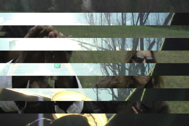

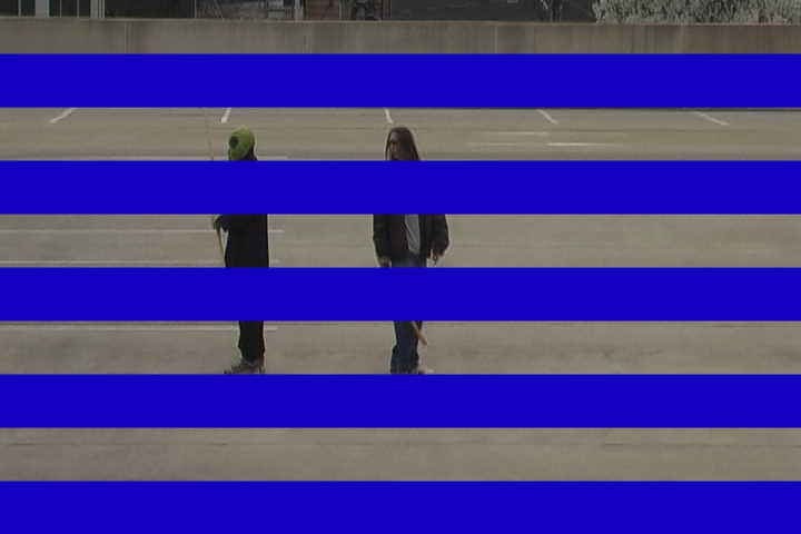

This problem is occurring more and more frequently. If you look at my picture you'll see that the last clip is combined with the clip I recently recorded. It normally occurs during the first clip I record but I've seen it happen in the middle of my shoot also. My camera is the PV-GS320. Any suggestions?
Thanks Alot!![]()
I agree. One of my DV camcorders (the most expensive, of course) did this a lot. A head cleaning cassette worked for a while but eventually it failed to do so and each other band ended up being just noise.
Try a cleaning cassette first. If it persists then the head will need servicing. -
Thanks alot for the quick response!
I thought that might be the problem. This really bothers me because the camera is only about 2 months old and I already sent one back because it was defective.
