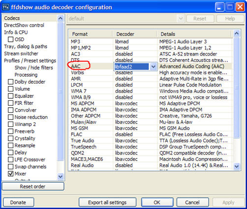

    What are you are using to decode AAC audio? If it's not already turned on for AAC, check in the ffdshow audio decoder configuration

    As for AAC and ffdshow ... might need some help there.I do have ffdshow installed but not sure what I use for AAC.I do have AC3filter installed.

    Here is what I have.

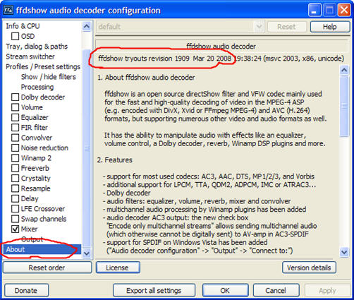

    What version of ffdshow? Scroll down and select "about". Perhaps you need an upgrade.

    My ffdshow is from Feb 08 so an update is needed though I wouldn't think that is being so much out of date.

  11. Toggle it off in the configuration window; there is a drop down menu -> change it to disabled instead of libfaad2

  13. I meant toggle AAC off in the ffdshow audio configuration (like in the screenshots above, except "disabled"), because it might be interfering with QT Pro's playback
