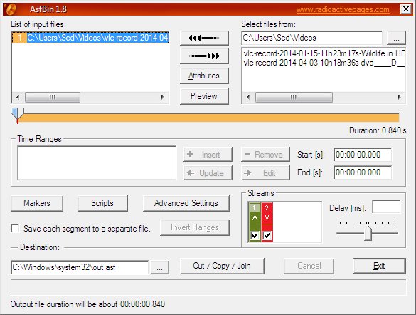

    The original quality was low to start with and you're only making it worse by re-encoding to a low bitrate. Try editing "losslessly" with AsfBin to avoid further recompression.
    Hy, thanks to reply my question. I have downloaded AsfBin and run the program then i cut the movie, but what progam's button can i edit "losslessly". Sorry to be a little n00b.
    AsfBin does only lossless editing and that's why you're only limited to cutting, joining and extracting tracks. "Lossless" means that no re-encoding/re-compression is done and thus there's no quality loss.
    I tried it but really not works. I think that Windows Media Player Streaming on Websites has something different compared with Youtube/Blogger...
