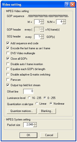

Open CCE manual and you will see this :
when you pulldown :
When you output DVD video stream with this option ( pulldown ), GOP sequence should be M=3, N/M=4
But the Doom9 guide says :
Change the N/M parameter to 4 for PAL content and leave it it at 5 for NTSC content
that's what I'm saying that is wrong, but that is just my interpretation, correct me if I'm wrong -
I haven't looked at that guide in YEARS ... if it is the one I think it is.Originally Posted by Delta2
Anyways you are correct that for 23.976fps you would use the "PAL" setting of 3, 4 and not 3, 5
Doom9 is assuming it's true interlaced 29.97fps NTSC. Either he's ignoring or was ignorant of encoding for progressive 23.976fps with pulldown applied to output interlaced 29.97fps. For true NTSC (interlaced or hard telecined 29.97fps), as opposed to FILM, that advice is correct. He's German; what does he know about pulldown? Joking...just joking!Originally Posted by Delta2

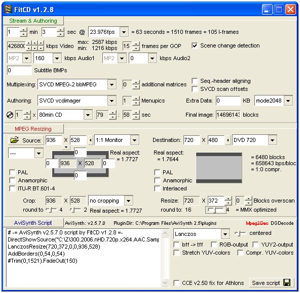

I downloaded the file 300.2006.nHD.720p.x264.AAC.Sample.NhaNc3.mkv as posted by user Delta2 (see his post in this thread for that download link or just click the file name here to download it). This is a MKV with H.264 video and 5.1 AAC audio. This is my "mini-guide" on how I converted it to standard NTSC DVD Video format.
First thing I did was to load it into XviD4PSP 5.0 and I demuxed the video and saved the AviSynth file that it created. This is what it did:
I then loaded the MKV into FitCD to check the resizing and FitCD gives slightly different numbers at the "default" settings but with some "playing around" I got it to match:Code:DirectShowSource("C:\Z\300.2006.nHD.720p.x264.AAC.Sample.NhaNc3.mkv", fps=23.976, convertfps=true) Lanczos4Resize(720,372) AddBorders(0,54,0,54)
So OK I stick with that resizing but I don't trust the DirectShowSource method. So I fire up DGAVCDec and load the demuxed *.h264 file and create a dga file (which I called sample.dga). The only thing you have to change is to make sure you have it set to FORCE FILM before saving the project file (that's the dga file). So now my AviSynth script looks like this:
I added in the RemoveGrain filter. It is a "video noise" filter. The setting I used is the "lite" setting. The ConvertToYUY2() part is there because I'll be using it with CCE SP which works in the YUY2 colorspace.Code:LoadPlugin("C:\VIDEO\dgavcdec100a23\DGAVCDecode.dll") LoadPlugin("C:\VIDEO\FILTERS\removegrain_25_dll_20050501\RemoveGrainSSE3.dll") AVCSource("C:\Z\sample.dga") RemoveGrain(mode=1) Lanczos4Resize(720,372) AddBorders(0,54,0,54) ConvertToYUY2()

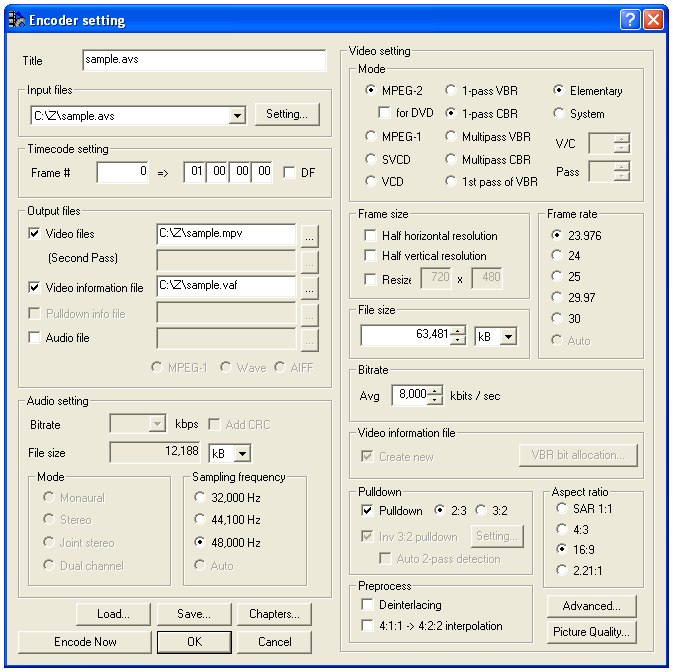

Now you are ready for CCE SP. I loaded my AviSynth script which I called sample.avs and here is how I set it up:
I then went ahead and encoded it so that I got a sample.mpv file.

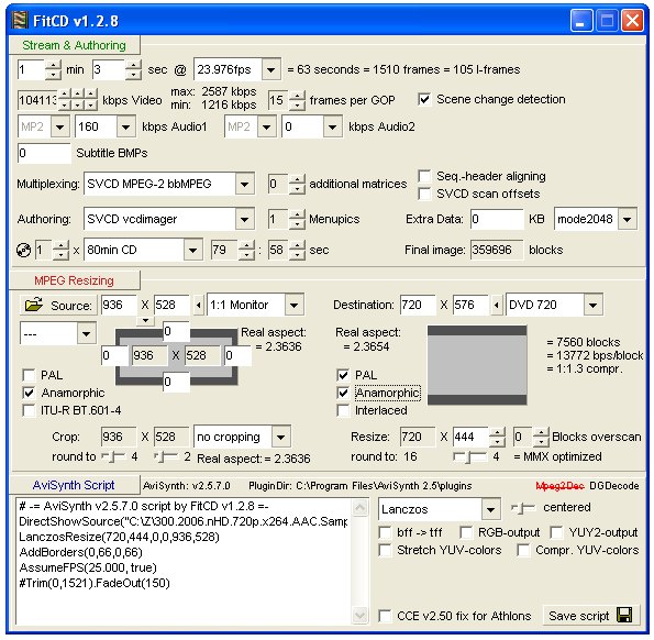

What's that you say? You want it in PAL DVD Video format? Damn you people are a PITA !!! :P
Actually it isn't that hard.
First let us go back to FitCD and do the following:
So taking those resize values I made a new AviSynth script:

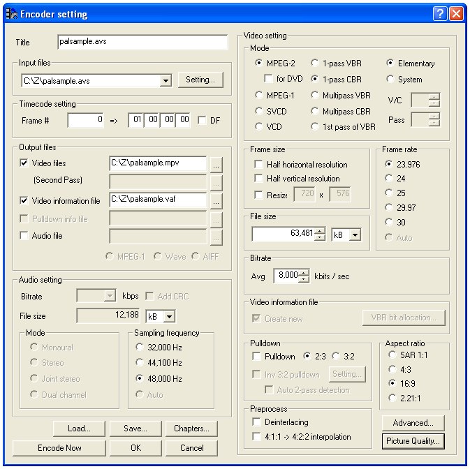

Now you are ready for CCE SP. I loaded my AviSynth script which I called palsample.avs and I set up CCE SP as before with this change:Code:LoadPlugin("C:\VIDEO\dgavcdec100a23\DGAVCDecode.dll") LoadPlugin("C:\VIDEO\FILTERS\removegrain_25_dll_20050501\RemoveGrainSSE3.dll") AVCSource("C:\Z\sample.dga") RemoveGrain(mode=1) Lanczos4Resize(720,444) AddBorders(0,66,0,66) ConvertToYUY2()
What did I change? Well first off I set up the other two CCE SP screens the same but on this screen all I did was uncheck the PULLDOWN option. After encoding I ended up with a file called palsampe.mpv which runs at 23.976fps without pulldown yet has a resolution of 720x576 so you could call this a "hybrid" since it has a NTSC fps but a PAL resolution.

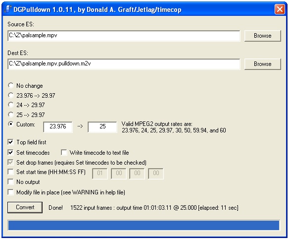

Now you need to fire up DGPulldown and do the following:
I then took the new created file and using the same AC-3 audio file created before I used MUXMAN to create a simple no menu DVD Video structure and then used ImgBurn to create an ISO file which I called 300_PAL_SAMPLE.ISO
You can download that file directly from this link: CLICK HERE
Please note this file is approximately 65.8MB in file size.
You can play this with VLC media player or burn to a DVD Video disc although a warning ... technically a DVD Video under 1.0GB is "out-of-spec" so some DVD players may bark at it. I've never had an issue though with any of my DVD players so if you have a DVD-RW or DVD+RW go ahead and try it.
Again the end result is a PAL 16x9 WS DVD Video.

Here is my first FitCD screen from the post above:
This works but technically I should have done this:
You will notice that the end result is the same. So really it doesn't matter 8)
Same thing goes with my second FitCD screen from the post above:
This works again but technically I should have done this:
Again though you will notice that the end result is the same. So once again it really doesn't matter 8)

Third I do not recommend Closing GOPs because it will lose quality, from CCE tutorial :
If Close all GOPs is selected, image quality will be slightly
degraded. Therefore, do not select this except when necessary
Why are you closing gops ?

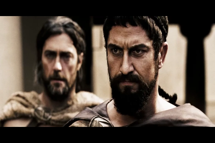

You know how they say a picture says a thousand words?
I created the following AviSynth AVS script:
Pretty simple right? My point is there is no resizing nor cropping going on.Code:LoadPlugin("C:\VIDEO\dgavcdec100a23\DGAVCDecode.dll") AVCSource("C:\Z\sample.dga")

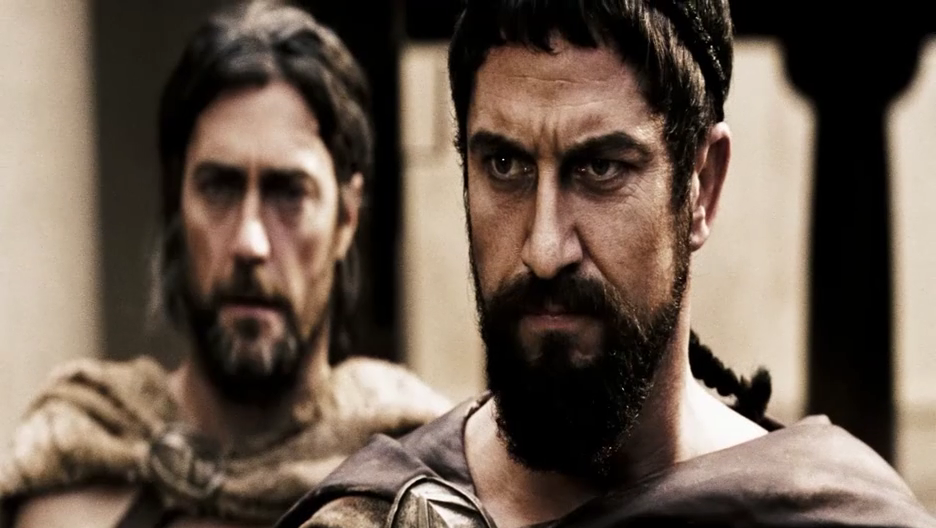

I loaded this into VirtualDubMod and did a "Snapshot source frame" to a PNG file.
This image is 936x528
So the image isn't 1:1 pixel ratio as I suggested. Sorry !!!
If you re-read my post about this you will see that it was actually XviD4PSP that created an AviSynth script and came up with the resize values and that I was only using FitCD to ensure that XviD4PSP got it right. It did.
XviD4PSP is one amazing program !!!
If you still aren't convinced:
Here is my NTSC AviSynth script:
Here is the same frame number (frame 1080) captured from VirtualDubMod when using the above script:Code:LoadPlugin("C:\Documents and Settings\John Coleman\Desktop\VIDEO\dgavcdec100a23\DGAVCDecode.dll") LoadPlugin("C:\Documents and Settings\John Coleman\Desktop\VIDEO\removegrain_25_dll_20050501\RemoveGrainSSE2.dll") AVCSource("C:\Z\sample.dga") RemoveGrain(mode=1) Lanczos4Resize(720,372) AddBorders(0,54,0,54) ConvertToYUY2()
This image is 720x480
Now we both know that for a proper 1:1 aspect ratio that you would take that 720x480 image and resize it to 640x360 so I loaded the above 720x480 image into GIMP and resized it to 640x360 to get this:
This image is 640x360
Now do you believe me my friend
- John "FulciLives" Coleman

The only thing you said that has some merit is the CLOSED GOP vs OPEN GOP argument. I for one prefer CLOSED GOP and this is not an argument I care to get into at this time.
