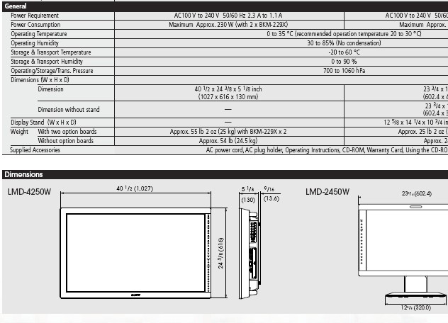

You can call the LCD-TV maker and ask. Non-operational temp specs aren't generally published for consumer products but they are for professional versions of the product.
For example, a Sony 42" Pro LCD monitor has the following specs.
http://bssc.sel.sony.com/BroadcastandBusiness/DisplayModel?m=0&p=8&sp=20131&id=92176
Operational: 0 - 35 degrees C (95 degrees F)
Storage: -20 to 60 degrees C (140 degrees F)
