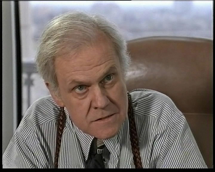

I need to shifting this video bottom area in right direction with few pixels.
Which avisynth script do this?
Sample video: http://djnice.uw.hu/dallas.avi
Sample frame:

Crop to two separate clips
Shift the lower section with crop and addborders
StackVertical the two clips back together"Shut up Wesley!" -- Captain Jean-Luc Picard

Except that cap is a bit funky and it's not going to work very well, as clever as gadgetguy's idea is. The download speed was too slow for that pretty big AVI, so I used the pic:
A=ImageSource("E:\Test\d1.jpg")
B=A.Crop(0,0,0,-24)
C=A.Crop(0,552,0,0)
C=C.Crop(0,0,-4,0)
C=C.AddBorders(4,0,0,0)
StackVertical(B,C)
As manono said, it will still look a bit strange. If you find that annoying, why not just crop off the shifted area?
In the beginning the Universe was created. This has made a lot of people very angry and been widely regarded as a bad move. -
Yeah, it's not just shifted, it's distorted. You might be able to get it down to line-by-line adjustment, but I suspect the distortion changes from frame to frame as well so it's going to be noticeable regardless. Unless there's some critical image content somewhere in the film it might be best just to mask it out.
