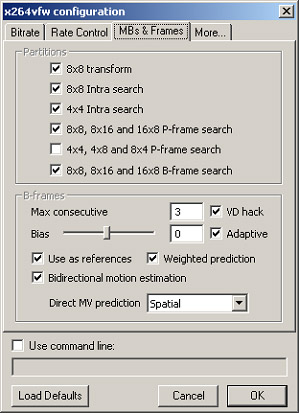

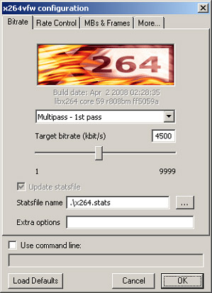

Here's the settings that I used:
(x264vfw build 11_808bm_12665 : http://sourceforge.net/projects/x264vfw/)
Notes:
- The target bitrate is typically set at around 700Kbit/s, and Max IDR-frame interval at 10 times the frame rate (250 for PAL, and 300 for NTSC). The values used above improve quality and future editability of the resulting video file.
- SAR (Sample/Pixel Aspect Ratio) = 16:15 for 4:3 PAL, and 9:10 for 4:3 NTSC.
ProCoder indicates PAL DV has a PAR of 16:15 (1.067), and Vegas indicates PAL DV PAR is 1.0926 (12:11). Putting aside this difference, and using 16:15 for PAL worked fine. Using 12:11 resulted in the video being scaled incorrectly on the ATI Media Player.
- If 'Max consecutive' is not equal to 0 AND 'Threads' is not equal to 1, THEN 'VD hack' has to be checked ELSE the video will lag the audio. That was the case on my machine anyway. -
Increasing the number of threads to four will allow each core to do it's share of the work. It should not introduce sync problems - it certainly doesn't on my quad core.

The problem was caused by the setting of B-frames Max consecutive to anything greater than the default of zero.Originally Posted by guns1inger
This is my note now on this audio/video sync problem:

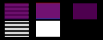

In YV12 encoded video the chroma channels are stored at half the resolution of the luma channel. So a 720x480 frame of video has the luma channel at 720x480 and the chroma channels at 360x240. Typically an encoder will convert RGB (4:4:4) to YUV (4:4:4) then downsize the U and V channels (4:2:0). If the scanlines aren't separated before downsizing the colors from the two fields get blended together.
Here is a correct example:
On the left is a crop from an interlaced frame of video. In the middle is one field (converted to a full height frame by duplicating scanlines), on the right is the other field. On an interlaced TV you would see these two fields one after the other. First the red box over a white box, then a blue box over a black area.
But with x264vfw's chroma downsampling bug you get this:
The colors of the two fields have been blended together. When you see this on an interlaced TV you will see a purple box over a white box, then a darker purple box over a black area.
Of course, I chose these two fields to show the problem at its worst. With most real world video it is not nearly as obvious.
Another thing to keep in mind: VirtualDub does not upsample interlaced YV12 video correctly for display and RGB filtering. It has the same upsamping bug that many DVD players had. It treats all YV12 as progressive. -

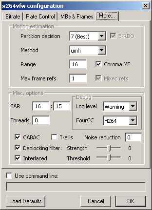

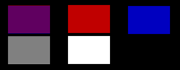

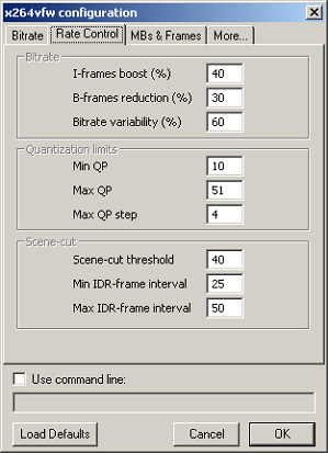

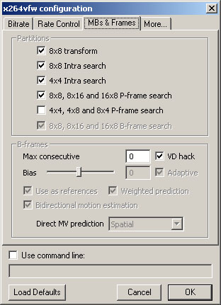

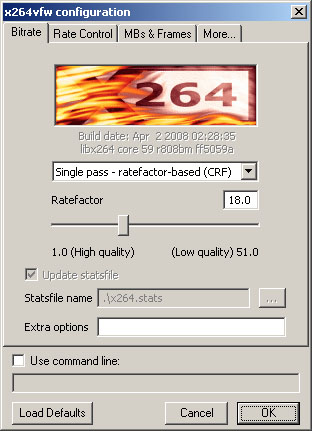

Putting aside the color space issue for now, I chose to press on with x264vfw so that I would have something to compare the other encoders against.
The following four images show how, using x264vfw and VirtualDub, I was able to achieve my goal of a video file that was both considerably smaller than the original DV file, while at the same time having considerably better image quality than an MPEG-2 file:
Notes:
- Values used for 'Ratefactor' and 'Max IDR' were selected to increase image quality and future editability, respectively.
- In VirtualDub, if 'Threads' is not equal to 1, then 'VD hack' must be checked; else the video will lag the audio.
ProCoder indicates PAL DV has a PAR of 16:15 (1.067), and Vegas indicates PAL DV PAR is 1.0926 (12:11). Putting aside this difference, and using 16:15 for PAL worked fine. Using 12:11 resulted in the video being scaled incorrectly in the ATI Media Player.
- B-frames are set at zero because although they improve compression, in an AVI file they cause problems for editors, including Sony Vegas. -
The major reason B frames improve compression is because they are compressed with higher quantizers (less quality). The idea being that you can sacrifice a little quality for short periods of time (the quality is cleaned up again by a later I or P frame) and you won't notice it much.Originally Posted by boblin2
In theory, B frames can compress better because they can reference frames before or after them. But in my experience, if you encode B frames with the same quantizer as I and P frames, you get very little additional compression.
Another reason to avoid B frames for video which will later be edited and recompressed is that the drop in quality, and later restoration of quality, is seen by the later compression codec as more changes in the picture, requiring more bitrate to encode!
