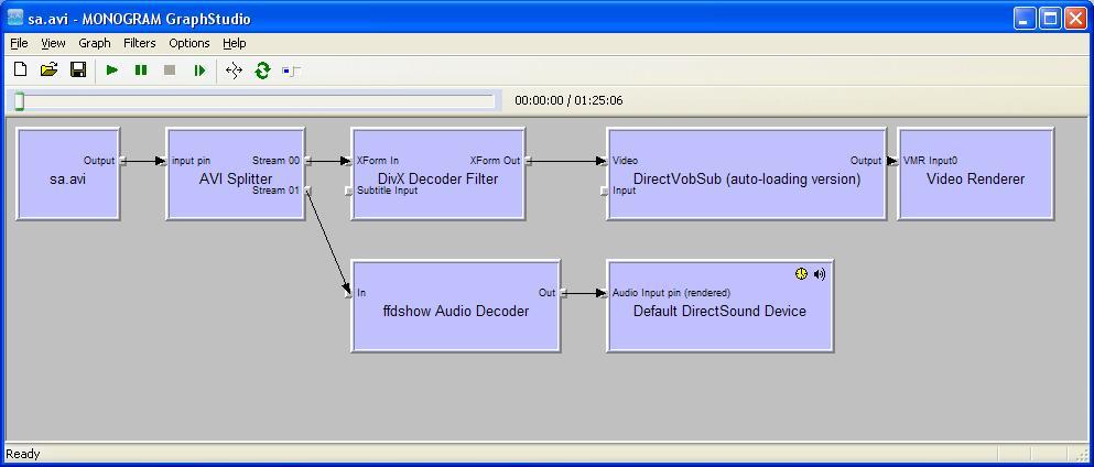

    Did you install vsfilter.dll? Does the sub have the exact same name as the AVI file?
    Usually you can test it with graphstudio. Render the avi, and look at the filter chain.
    You should see one of the boxes contain "directvobsub" and you'll see the icon in the tray,
    lower right.
    [Attachment 12888 - Click to enlarge]
  16. Originally Posted by davexnet View Post
    lower right.
    I changed the name to give it the exact same name eg movie.avi and movie.srt. Will look at the other progs thanks. But it is really on my LG BD350 i want to watch. Sometime the subs will show and sometime not with the exact same name. And sometimes out of sync
