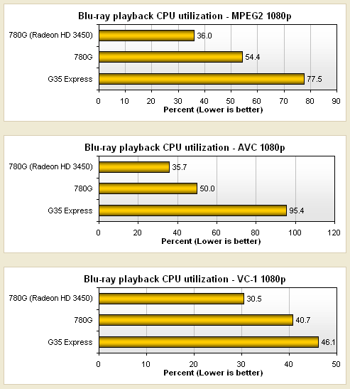

Tom's Hardware has an article about building a 780G-based HTPC that could play 1080p with onboard video and a low-end processor. http://www.tomshardware.com/2008/03/04/amd_780g_chipset/index.htm -
Tom's Hardware had an article :POriginally Posted by Constant Gardener
Here's TechReport's version of the 780g chipset
http://techreport.com/articles.x/14261/1
Essentially it's integrated graphics version incorporating ATI HD2400 from last generation
You are still getting 40-50% CPU usage on an AMD X2 4850e for 1080p playback. I dislike PowerDVD, but you still need a software player that enables hardware acceleration
