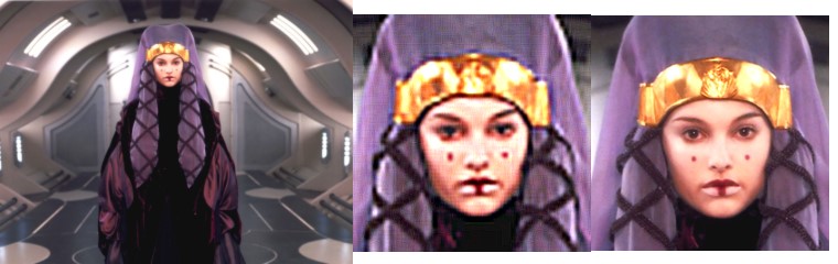

Here's an example of what you might expect:
On the left is a 320x200 image similar in size to what you will find on youtube. It's sharper and cleaner than most videos you will find there. In the middle is an enlargment made from that picture. You might get a little better results by working harder at it or by using "super resolution" techniques. (Super resolution techniques use data from multiple frames to get better results.) On the right is what you won't get! (The left image was made form the same large image the right image was cropped from.) -

Thanks for the visual and details. From what I have learned about this so far I need to get the original tape or a copy in order to do what we need to accomplish.
