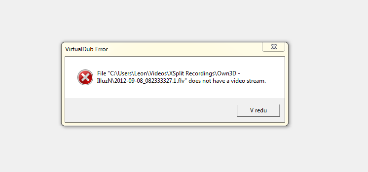

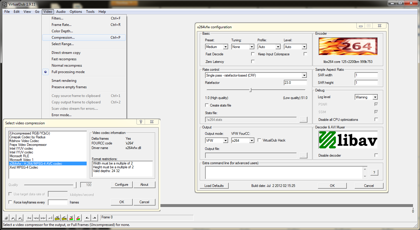

    Hi.
    I'm trying 3-4 hour's to solve that problem and still dont know what is wrong
    Here is screen:

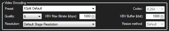

    All my video is recorded with Xsplit Broadcaster(720p & 25,00 FPS).
    I'm using VirtualDub 1.9.11, FLV Input Plugin from http://moitah.net/ and
    i try with install http://sourceforge.net/projects/x264vfw/files/x264vfw/ because of x264 codec but still dont work.
    Can someone help to solve this problem?
    I don't have any idea anymore, what is wrong
    Tnx for any tips/help.

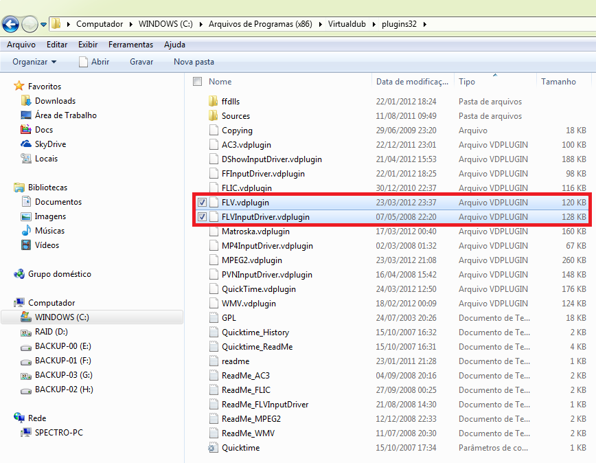

  7. Lone soldier Cauptain's Avatar
    Jan 2006
    Brazil
    Originally Posted by IlluzN View Post
    Hi.
    Here is screen:
    [Attachment 14814 - Click to enlarge]
    Download FLV plugins for Virtualdub, Open, select flv plugin and try.
    Claudio

    @ IlluzN: the input plugins by Moitah are outdated, give a try to the FLV plugin by fcchandler:
    http://gral.y0.pl/~fcchandler/Plugins/FLV/index.html
    and get an up-to-date VfW x264 from komisar's:
    http://komisar.gin.by/
    Also, notice that the input plugins were NOT designed to deal with improperly-muxed files.
    Nov 2012
    Maribor
    El Heggunte i try it but still the same error
    Maybe if someone have "worked version" of VirtualDub and FLV files can .rar the whole program and upload it somewhere..?

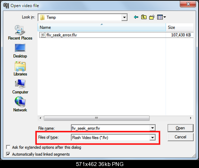

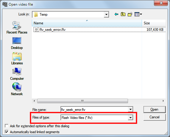

  10. Make sure the FLV plugin is used when you open the file. Use the "Files of type" pulldown in VirtualDub's Open Video File dialog to force the FLV plugin.
    That way you'll be sure the FLV plugin is being used, not another.
    If that still doesn't work, use MediaInfo to verify your files are really FLV files. If the is really FLV and you still get that error message there is just some incompatibility between the file and the plugin. Try using a different source plugin like ffmpeg or DirectShow.
    Nov 2012
    Maribor
    jagabo tnxxxxxxxxxxxx. Because of this "Files of type" video didnt work tnxxx finally work

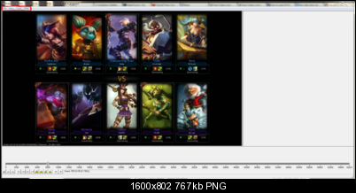

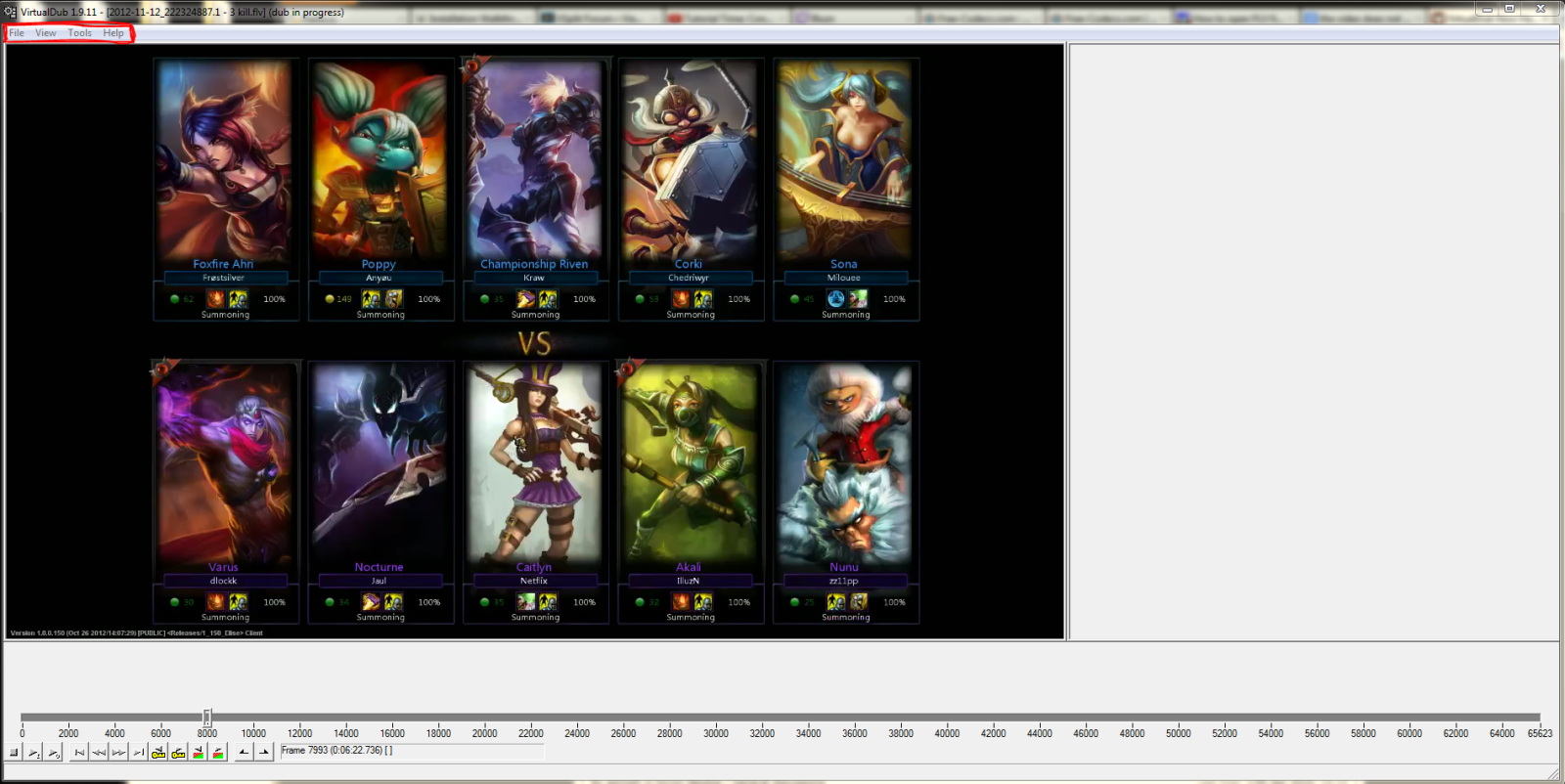

    hm. now i have 1 more problem. video is open but all options for "edit" video is gone..
    i have 20 GB of streams and want to create movie really need to solve that problem or some other programs where i can create movie.. some idea?

  13. Originally Posted by IlluzN View Post
    Why does the title bar say "dub in progress"?
    Nov 2012
