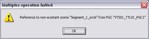

So I started again with Muxman, this time importing the chapters. unfortunately it failed and I got the following message.
Do you think there is something to do with the demuxing?
or maybe the original dvd files? this is a re-authoring with DvdShrink of a 3 hours movie that was in 2 parts on 2 DVD's. It plays fine with Windvd except for the gap between the 2 parts and the fact that when you are in one part you cannot go to a chapter in the other part. -
No. It mentioned SCN6. Check out the frame numbers of all the cells (are there really only 6 lines in the celltimes.txt?) and make sure that none are within 50-60 frames or so of each other. If you find any too close together, remove one of them, probably the first in the sequence. You might want to make a backup of the original Celltimes.txt file (called maybe CelltimesOriginal.txt) before removing cells, in case you want to later remove a different cell before authoring, or in case something messes up.Do you think there is something to do with the demuxing?
