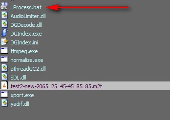

First, you must process it so it is less than 250MB in size. This script will convert your file to a high quality but smaller Xvid file which you can upload to Vimeo.
1 - Install Avisynth
2 - Download and unzip Convert_M2T
convert_m2t.zip
3 - Copy your .M2t file into the same folder and double click _process.bat to run

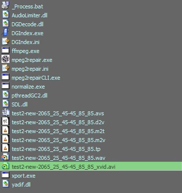

4 - The completed file
Voila
test2-2008_03_21-16_28_32_xvid.avi
