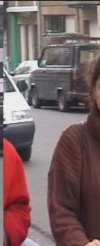

    2) when an object in the video moves quickly, I can see these strange lines in the object. It's like the object turns into a bunch of horizontal lines, alternating transapant and opaque, as it moves. it happens very quickly, but I can see it.

    2) The interlace comb artifacts are exactly what's on your DV tape. The display on your camcorder is hiding them from you.

    2) You're seeing interlacing lines. This is normal on a PC monitor. DV is interlaced, monitors are progressive. Those lines will not appear on your final video on a TV.

    Hi,
    I've downloaded today "WinDV" in order to transfer my old miniDV tapes to my PC.
    I've carried out a test and I've noticed that sometimes I have some noise (a thin vertical strip on the left of the picture). This strip doesn't show on the camcorder screen while it appears on the AVI file.
    Moreover, when displayed on TV from the camcorder this strip doesn't appear.
    I've tried to transfer the tape content using another software (the native Import Video from Vista) as well as another format (.wmv) but face the same issue.
    Attached you can see a screenshot of the movie (I've croped it to focus on the left).
    Can it be due to the heads of my camcorder (I don't have a special tape to clean them)?
    - Probably not as this "noise" is only present once in a while
    Can it be due to the fact that the extract is slightly larger than what is displayed on a PAL screen?
    - If so, can I crop the movie?
    Can you please help me to solve that issue or advise me another freeware?
    Thanks,
    J-O
  10. That strip is probably part of the DV data recorded on the tape. You don't see it on TV or on the camcorder because those devices overscan. You don't see the outer few percent of the image on all four sides on those devices.

  11. aBigMeanie aedipuss's Avatar
    Oct 2005
    666th portal
    that screenshot doesn't look like noise to me. more like the cam head is mis-aligned and that "noise" should be part of the last frame or the cam is dying, especially if it starts happening more often.
  12. Member 2Bdecided's Avatar
    Nov 2007
    It's quite normal for (especially older) DV camcorders to put something strange right at the edge of the picture - no one was going to see this on a TV.
    I think aedipuss is wrong. I'm very familiar with DV errors - they never look like that.

  13. I now use Enosoft DV Processor to transfer DV.
  14. Originally Posted by MOVIEGEEK
    Why, thank you
    Anyhoo, looking at the sample image it is (as others have suggested) just part of the way DV is. There are nearly always 8 or so pixels of padding on the left of the image. It may appear as junk or a solid color or whatever the manufacturer ended up doing. It this specific case, it looks like the same pixel is repeated horizontally.
    John Miller

    Belgium
    Hi,
    Thanks for your answers.
    If this strip is the outer few percents that usually are not seen on a TV, how can I crop this digitally without affecting the quality?
  16. Most editors have cropping, masking, and/or fill tools. Re-encoding with a lossy codec will always result in some loss of quality though.
    Nov 2009
    Belgium
    Hi guys,
    I've tried to transfer the file back to the tape and indeed the strip doesn't show.
    Therefore it's clearly additional information not shown when played on the camcorder or on TV.
    However that shows when played on a computer, especially due to the fact that the source is 4/3 and my LCD is 16/9.
    By the way I have some tapes recorded in DV 16/9 and they seem to be captured in 4/3 on WinDV. Is there any setting to correct this?
    Thanks.
