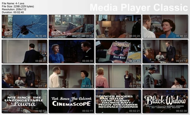

    I remembered something I got from Baldrick the other day (thanks Baldrick!) that you may (or may not) find useful. I used a movie trailer I had lying around and this script:
    LoadPlugin("D:\AviSynth Stuff\Dlls\DGDecode.dll")
    MPEG2Source("E:\Black Widow\4-1\4-1.d2v")
    Crop(2,8,-14,-10)
    LanczosResize(208,112)
    SelectEvery(240,0)
    I opened the script in Media Player Classic and then File->Save Thumbnails. I resized them a bit to fit on this page:
