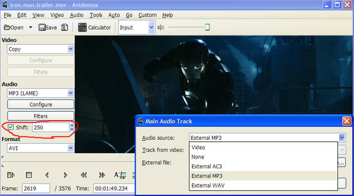

  7. One approach would be using avidemux. If your audio & video are roughly the same length, it should work, otherwise you may need to cut some video off (with avidemux) or an audio encoder to cut some audio off.
    You can also use YAMB to demux if you want, but you should be able to open the .MOV up in avidemux, and specify the audio from another track. (audio=>main track=>audio source=> (drop down menu) => external mp3 => point to location "external file"
    On the video sidebar, set "copy"
    Audio sidebar, set "mp3". You can also do the audio shift. In this example I have set +250ms (see attached). Adjust as necessary
    Format, set "mp4" - (in the photo it says "AVI", but I bet your .MOV is h.264, and h.264 doesn't always play nice with AVI) It shouldn't matter since YouTube re-encodes everything anyways
    Press save, with extension (e.g. "myfile.mp4")

    Poisondeathray,
    What you told me to do worked like a charm! I simply shifted the mp3 200ms and thereby obtained a good sync. Thanks a lot for uploading thoses screenshots. That made my task much easier.
