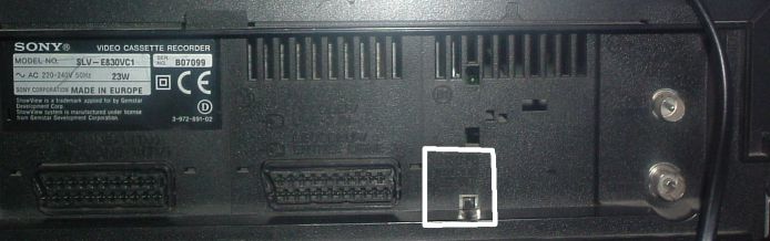

    On back VCR set the switch on NTSC 4.43 (right position for my unit, true NTSC signal) and in capture software set NTSC (720x480 and 29.97FPS).
