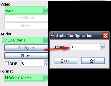

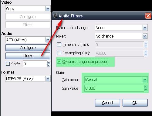

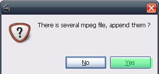

    Actually, AVIdemux might work quite well in your case. Give me a few minutes to try it out.
    http://www.razorbyte.com.au/avidemux/2.4/SVN/3872/avidemux_2.4_r3872_win32.zip
    Open the first file of the series (copy them to your hard drive first)
    Change the settings to reflect the ones I set below
    Then save the file as Output.mpg or similar. Good luck. I don't do very much DVD related stuff. Perhaps someone else can come up with an easier solution.

    I tried this and what it actually does is increase the gain... which might be what the op was looking for.
    Any idea on how to do dynamic range compression on a MPG?
