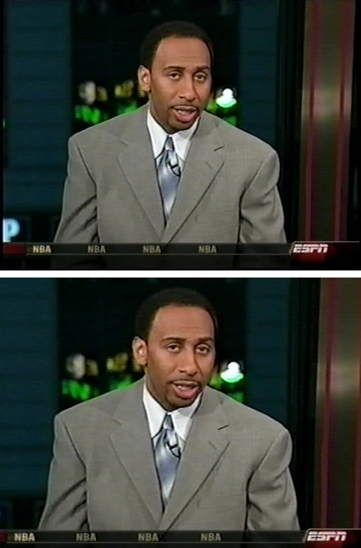

    I can't take a picture of my TV screen, but I can simulate what I'm seeing.
    The top image is what plays back after recording my on DVD recorder. It looks exactly as it did when it aired live.
    I took the vob file from that recorded DVD and made a new DVD with my authoring software. When I play back that DVD on my television, the picture looks as it does in the bottom image.

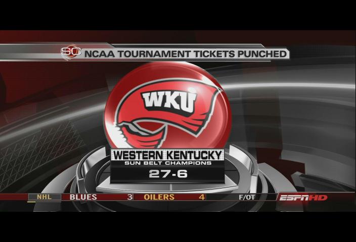

    I capped the analog ESPN1 off Comcast here to a 704x480 project timeline. It was somewhat narrow and H shifted right but all 480 vertical lines are there. My 4:3 TV displays similar to your lower picture (overscanned).
    704x480
    This indicates your top image (DVD recorder) is displayed full to edges and the lower image (DVD authoring program) is cropped. My DVD authoring program isn't cropping. There must be a crop setting in your software.

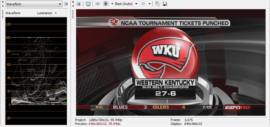

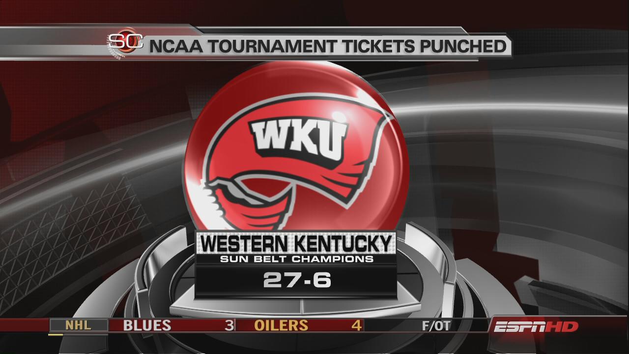

    For reference, here is the ESPN-HD 704x480i downscale
    And the 1280x720p --- click on picture to see full size.
    Yes the graphic highlight is clipping at 235
