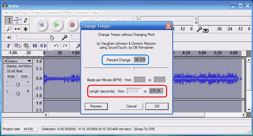

  4. What exactly is your audio sync problem?
    If the audio is off by a constant a mount over the entire video, for example the audio is 1 second late all the time, then you can simply adjust the skew to make it match. You would set the skew value to -1000 (1000 milliseconds = 1 second) to advance the audio by 1 second.
    If the audio starts out in sync, and slowly gets more and more out of sync as the video progresses, you need to adjust the length of the audio and/or the video so that the two match. For example, if the audio ends 10 seconds before the video you need to make the audio 10 seconds longer. You can do this with a program like Audacity. Once you have the longer audio you can add it to the original video as indicated earlier.

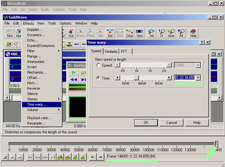

    What version of Virtualdub are you using? The new versions will handle VBR mp3 so you may not need to fix the audio first. If you do have to, Goldwave isn't free but it's alot easier to fix sync problems with than Audacity.
    Open the AVI in Virtualdub and move the slider to the end of the file to see what the running time of the movie is.
    Open the AVI (or use the wave file you saved with Virtualdub) in Goldwave > Under Effects, choose Time Warp and set the time of the audio to match the running time of the AVI > Save as 16bit WAVE or 44Hz MP3.
    Under Audio in Virtualdub, choose Audio from other file and choose the file that you saved with Goldwave. If you saved a Wave file then you'll need to choose an audio compression. If you saved an MP3 then you can direct stream copy both the audio and the video.
