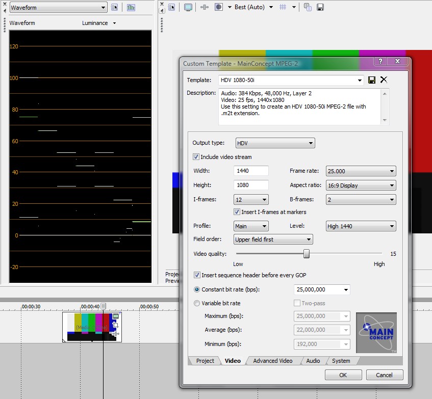

    Your question led me to bring up a PAL HDV project in Vegas 8 for the first time. As you can see, PAL HDV has an I frame (complete frame) every 12 frames. If you cut to I frames that would place a cut about every half second (i.e. 12/25). NTSC HDV places I frames 15 apart so accuracy is also about a half second (i.e. 15/29.97).
    The I frame and the next 11 motion compressed frames are called a Group of Pictures (GOP). A GOP can be decompressed back to 12 full frames with computation. It is this computation that makes zeroing onto a specific frame on the timeline difficult or laggy for MPeg compressed projects. Higher compressed MPeg4 is more laggy. High resolution frames add to the processing delays. The decompressed frames go to memory or tmp files. Tmp files add further delay since the disk system runs slower than the CPU and memory.
    So, given time you can find a frame and edit to a frame. When you export, new MPeg GOPs are encoded at cut points from the frames stored in the temp files.

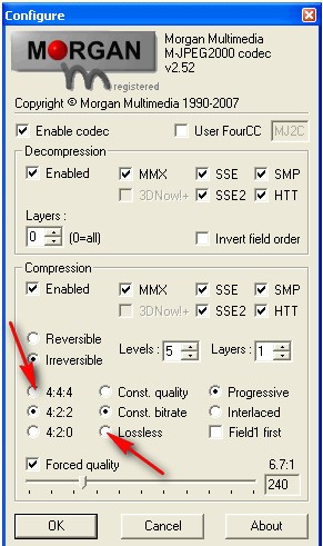

    There's also an alternative in the $30 Morgan Mjpeg2000 codec, although I haven't tried it yet. Some nice features, including Multi Core processing and 4:4:4 color space. http://www.morgan-multimedia.com/M-JPEG2000/

    Did some quick tests. Morgan does a good job of compression but took longer to transcode. Decoding seems really fast - scrubbing through in Premiere seemed fine. Here's a file size comparison:
