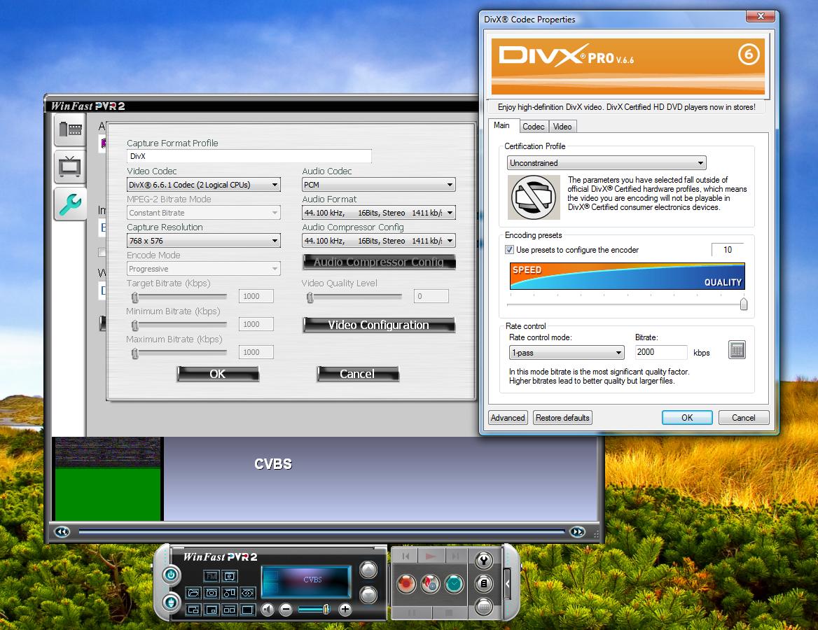

  23. I tried both on this software and Virtual Dub.
    sonething wrong here?
  24. Ok, you're capturing at 44.1 KHz, 16 bits, stereo. Make sure the audio compression uses the same settings.

  26. I don't use the same capture device so the software I use won't work for you (Hauppauge WinTV PVR-250 and WinTV2000).
    The screenshot you posted shows that you are capturing as PCM. That would be uncompressed. The files you capture that way should play properly. Do they?
    Try changing the Audio Codec to Lame or some other MP2 or MP3 encoder. Then use the Audio Compressor Config to set the compression parameters.

    When I work with Winfast PVR2 (the one from the pic), I don't get any audio. why?
    I desperated!
    All I want is to make simple AVI from the VHS, someone can give me a simple guide for this?
  28. From what I understand your capture card does not have audio inputs. So you must be using your sound card to capture the audio from the VCR. This very often causes audio sync problems. I find it's often necessary to record the audio uncompressed with this type of setup.
    Make sure the WinFast PVR2 software is configured correctly to capture audio from your sound card. Your sound card may have more than one input (line 1, microphone, etc.) so you may also have to configure the sound card via it's setup applet.
    For example, the WinFast software might be set up to caputre from the sound card's "default" audio source. This means you have to use the setup applet to specify which source to record. Or you may be able to configure the WinFast software to capture from a specific port on the sound card. Make sure the audio mixer doesn't have the particular input port muted.
    I just noticed in your screenshot that you have Divx set up to use the encoding preset at 10. That is too slow and guaranteed to cause dropped frames. Move it all the way to the left for video capture. Or turn off the presets (you have to have a registered version to do this) and use the settings I gave ealier.
