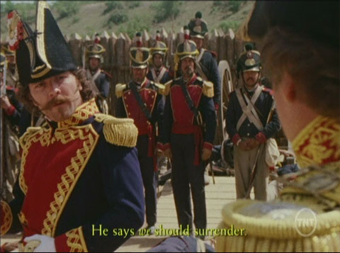

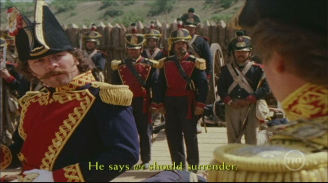

    TBS-HD sometimes uses something similar for 4:3 versions of movies.
    This is on the TBS SD channel. Actually the SD channel is proper aspect ratio all the way across. I just H scaled this from the picture below.
    This is how they distort it to 16:9. It looks worse in movement as people change thickness as they walk across the screen.

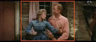

    The 4:3 version is usually a pan-scan crop from the original 2.35:1 aspect movie print. Stretching the 4:3 crop out to 16:9 produces strange results.
    Here is a great example of pan-scan that I found here http://content.answers.com/main/content/wp/en/7/74/PanScan7BridesPan.gif
