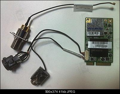

    Third: my own built capture card. (3D comb filter). Good solution for LD but also for VHS tapes due his TBC built-in. If you like this one PM me.
    Just want you all to be aware the the X-Card mention by Danno78 above as being built by himself is partly correct.
    The X-Card is a OEM "Aver media Mini PCIe DVB/ATSC TV Tuner card with a built-in SAA7136 v2 chip" similar to this one that can be picked up cheaply off eBay.
    All that Danno78 has done is mount the card onto a Mini-PCIe to PCI-e bracket and fitted wires for video and audio to the 10pin connector on the side of the card.
    The SAA7136 v2 chip contains a 3D/YC filter but no TBC (Just a phased locked loop)
    The problem I had with the bought X-Card from Dano78 was that it was covered in lots of epoxy, glue and plastic weld to prevent you investigating the card and a RF-shield and wonky oversized glued on heat sink which is not needed. (Very badly constructed)
    Also any chip identifications have been removed to prevent you from discovering the original origin of the card.
    Also I discovered the composite signal was not wired to the cards composite pin within the 10pin connector but to s-vhs connector which means you have to preform a procedure with graph edit to reroute it.
    Also non of the grounds are connected to the mini-pci-e card but to a make shift resistor network, which means I had noise and a nice DC offset on my signals.
    I since have rewired the card correctly and it now works as it should do.
    If anyone requires the pinout of the 10pin connector to make there own card pm me.

    Ironwood,
    Curiosity led you to disamble the card and the perfect excuse was improper functioning. This is the truh. Even before you You have decided to buy the card you asked many times about what is behind. I was very clear about this: no information about this subject. After you got the card on December 11, the second day you asked about drivers for Linux. No complain were made about the build quality and nothing about "horrendous noise levels, on the video and audio channels". Horrendous noise level were "Very noticeable when you link up to a scope" At a such level the noise will come out from screen and in the same the scope was need to show them. From December 12, until you have posted your review no feedback I received. I asked several times (via PM and mail) impressions and got a totaly silence. If your complain were real then you should ask explanations and solutions. The sturdy build turn againt you when have decided to disamble. On build quality I agree in one point: was not build to win beauty contest.
    I sent a card with all promised features available and in good condition. After reading your posts the concusion is this: the card is bad when come danno78 but if come from you become usable.
    Just check the card with one VHS tape. I think will be surprised. It is my gift to you .
    Happy New Year and please not come again with untrue statements, which are intended discredit me.

    Hmm,
    Happy New Year,
    When you pay $155.00 USD or £95 and and a product arrives looking like a 5 year old had assembled it, you begin to ask yourself, hmm I have been ripped off.
    You claim the card you provide is, made by yourself.
    It is not, it made my avermedia. It an OEM HP or Dell ATSC / DVB TV tuner with av port
    You claim the card had a built in TBC, it does not.
    You alter the text in the driver description files to hide the fact the card is avermedia and claim its a TBC card.
    You present a card with shoddy construction that has been deliberately made so no one can investigate.
    You deliberately file off any chip identifications.
    The card is not even wired correctly as no connection is made to the composite input pin.
    The ground wires are not connected correctly.
    Why all the steps to hide the true origin of the card? Why the deception, what are you trying to hide?
    If I was to make such a modification and sell it, I would be open in what I had done, and not try to deceive.
    I would give people clear instructions on how to do the modification for themselves and for those who can not, offer a service at a nominal price to do this.
    I did a check on eBay and I can pickup a card for approximately $10 and do the required modifications easily.
    How much profit are you making 300-400% more?
