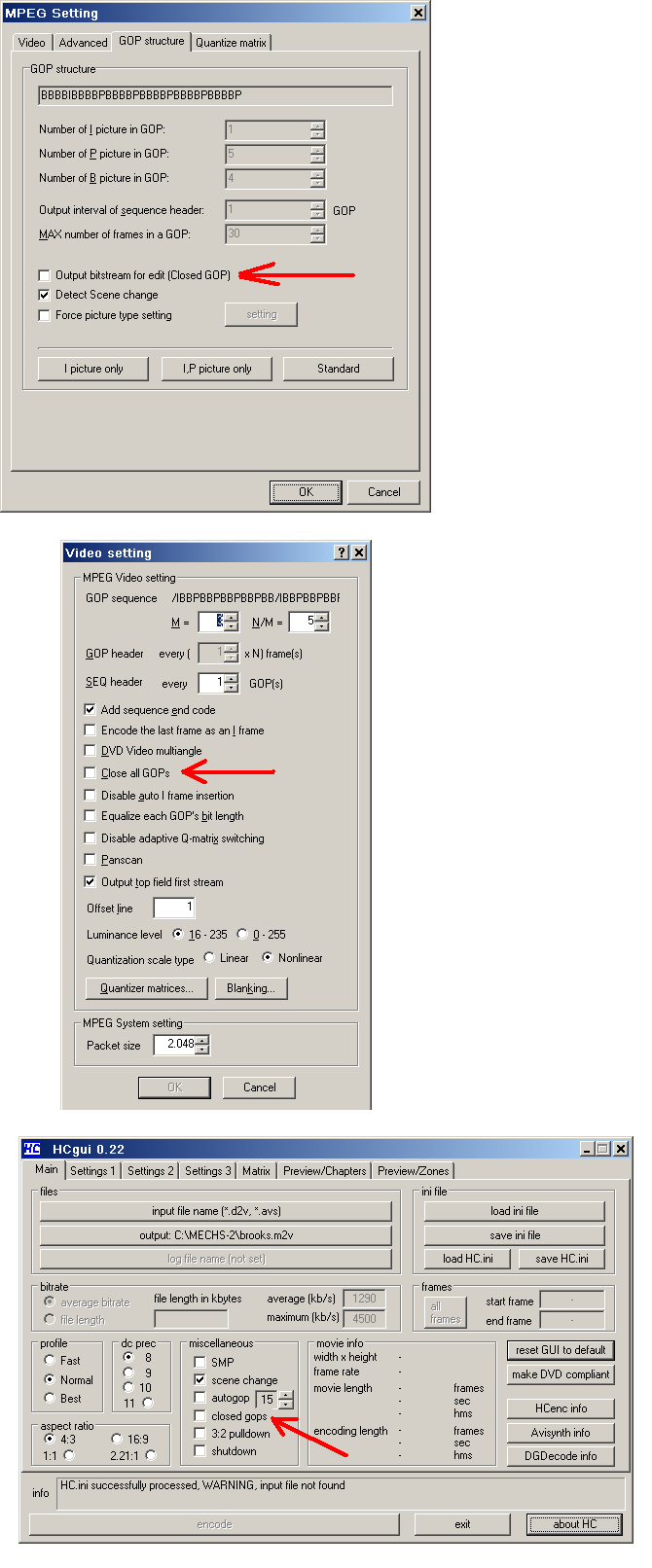

    Prompted by another poster here and fueled by the fact that DVDLabPro always warns me that I have open GOPs, I thought I'd ask the question:
    What difference does it make?
    The discs I burn always work in all my machines and I never get complaints from folks whom I give discs to.
    I must admit that I always ignore the warnings DVDLabPro gives me, but it's because I've never run into trouble.
    And that leads nicely into the second part of the question: How do I get closed GOPs? The authoring app. gives me the warnings whether I feed it video that I've encoded or video that I've captured via my PVR-350.
    Thanks all.
    If you meant "how to close the GOPs after the video compression has been done",
    then my answer is "I don't know, and I don't want to know".

    So, for the folks who capture directly to MPEG2, how do we get closed GOPs without re-encoding? Or do we?Obviously, if we capture at an unusually high bit rate, we can re-encode down to one within DVD spec. and close the GOPs.
    Recommended or not?

    About the joining, if the first GOP of the second clip starts with IPB... (stream order), it should work OK, then the GOP is closed.
    The brightly colored blocks mean of course the first B-frames of the second clip try to reference the last P-frame from the previous GOP, then the second clip starts with an open GOP, IBBPBB...
    But if the second clip isn't edited, (cutting of the first closed GOP), IMHO it shouldn't produce junk frames.
    If you join the clips do you also remove the sequence_end_code header from the first clip (four last bytes: 00 00 01 B7)?
    Some HW decoders don't like it when there's a sequence_end_code in the middle of the stream.
