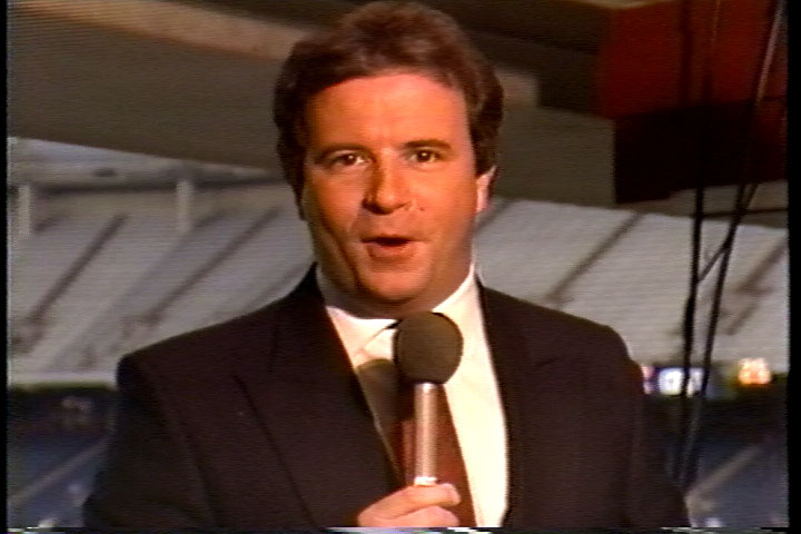

    I'm trying to convert a VHS tape of a State Football game recorded from cable. I captured the video to PC using WindDV, and need help correcting the color. Looks like to much red.
    I'm using VirtualDub, and I have ColorMill but don't know how to use it. I also have Red/Green/Blue Adjustment filter as well. I'm also planning on using NeatVideo to remove some of the noise, and the Filler filter to remove the noise at the bottom of the video. Other than that I can't see anything else wrong with this capture.
    Any help on color correction would be appreciated.

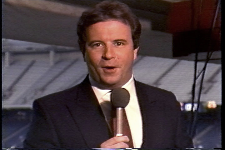

  2. Try HSV Adjust. Turn the Saturation down a bit. Maybe to 75%.

    In Photoshop 6.0, I used levels to adjust the neutral colors in the back ground
    so that they actually look more neutral. Then desaturated the red channel a little.
  9. nice job with photoshop davexnet

    Nothing a proc amp wouldn't fix in analog. That would have been best.
    TMPGEnc Plus would be my tool of choice to adjust colors here, in software.
    Advanced color corrections. Probably needs a stacked set of filters. It's really not that bad.
