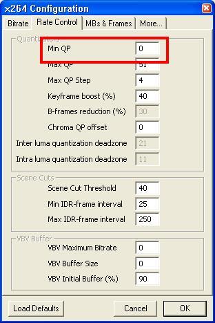

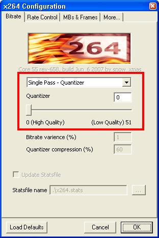

  7. I did the experiment with a VFW version of x264 and VirtualDub. Using constant quantizer mode just select "Single Pass - Quantizer" and set the quantizer to 0:
    In constant quantizer mode you are telling the encoder to use whatever bitrate is necessary at each frame to maintain the requested quality. You don't know beforehand what the bitrate will turn out to be.
    I encoded a short 1920x1080 29.97 fps clip with constant quantizer 0 and the bitrate turned out to be 200000 kbps. Yes, that's two hundred thousand kbps.

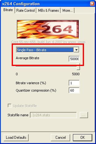

    In "Single/Multi Pass - Bitrate" modes just type in the bitrate you want:
    And set the minimum quantizer to 0:
    If you want really high bitrates just save without any compression.
