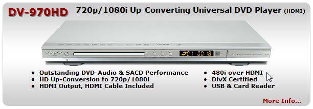

Interesting that high end DVD players are making a feature point of 480i/576i support over HDMI. This is to allow a premium HDTV set to handle the IVTC, deinterlace and upscale processing from an all digital feed thus avoiding the repeat scaling.
oppo example

I didn't try using 480i, only 720p and 1080i. I never even thought about 480i. With my SD DVD player over component, it makes no difference wheather it's 480i or 480p.
It may not make much difference for PAL or progressive NTSC DVD (movie DVD) but 480i vs 480p is important for processing 480i TV captures (e.g. from DVD recorders or computer capture cards).Originally Posted by samijubal
480p setting forces the DVD player to do the inverse telecine or deinterlace of 480i source. 720p or 1080p setting does too.
480i setting passes inverse telecine or deinterlace of 480i source to the HDTV for processing. If the source is progressive 23.976, the 480i setting forces the DVD player to add pulldown (telecine) to 29.97. Then the HDTV inverse telecines that back to 23.976 progressive and upscales.
If the DVD player is set to 1080i, a 480i source is upscaled and passed as 1080i. Upscale methods vary from poor to very good. Progressive 23.976 gets telecined to 29.97 and then upscaled to 1080i. Then the HDTV inverse telecines and scales to display native resolution.
In all cases progressive 23.976 fps gets frame repeated in the TV* 3 then 2 to 59.94 fps for display or on the newer sets gets repeated or interpolated 5x to ~120 fps for display.
* for 480p setting, the 3 then 2 repeat to 59.94 fps happens in the DVD player.Recommends: Kiva.org - Loans that change lives.

Bottom line, 480i tosses all the processing to the HDTV*. 480p/720p/1080p forces the DVD player to do the heavy work. With 1080i, both are working.
*480i over HDMI is similar to having the DVD player inside the HDTV with a direct digital read from the DVD disc.Recommends: Kiva.org - Loans that change lives.
