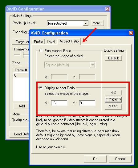

    You can set the aspect ratio to 16:9 with mpeg4 modifier. But many software players and hardware players will ignore the aspect ratio in avi xvid files. It's better to convert to a 16:9 frame size directly(1:1 Display Aspect Ratio), like 720x406 ( 720 / 1.77777777777777777).
  3. For future encoding set the Display Aspect Ratio option in Xvid to 16:9.
